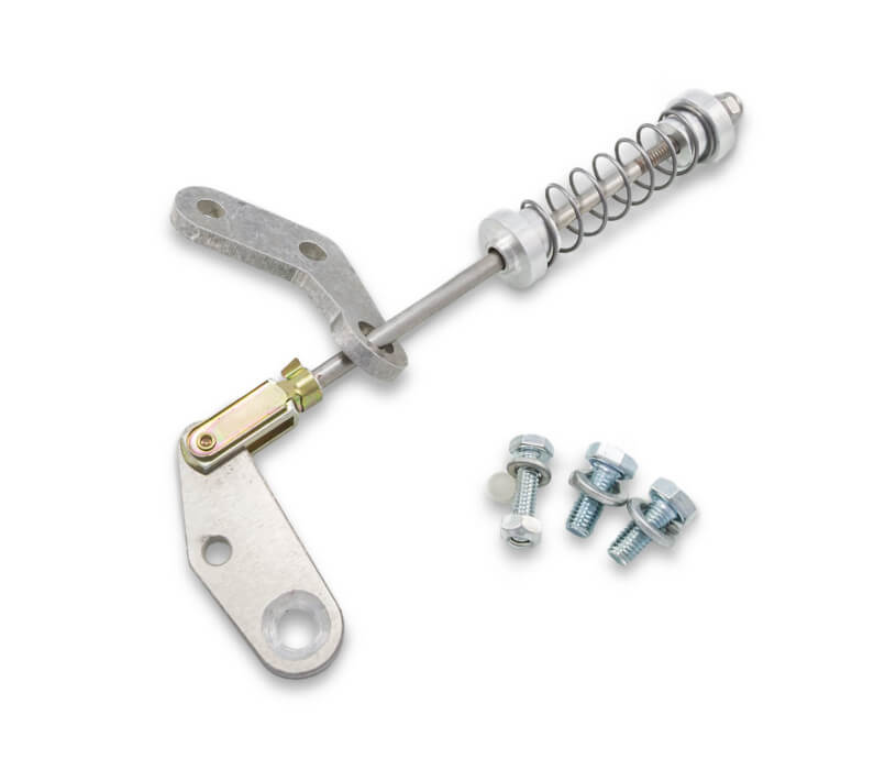

Approximately 21HP & 27 ft/lbs of Torgue gain to the H1 6.5 engine. Our RapBoost is designed to increase performance operations of the factory turbo.
